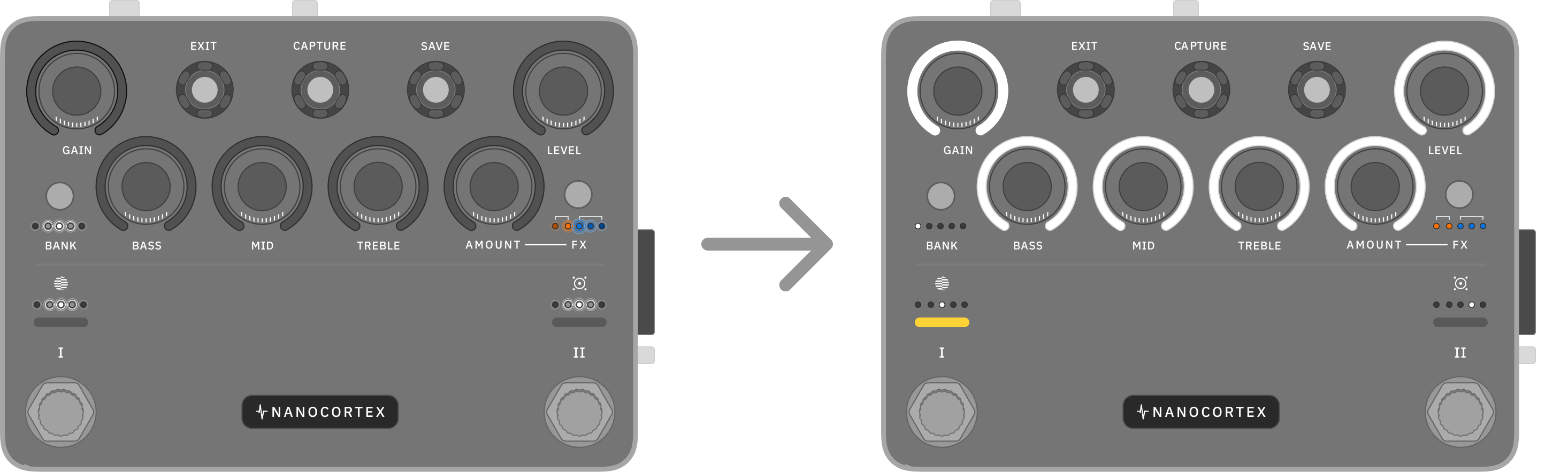

Turning on your Nano Cortex
Connect your Nano Cortex to the power source.
After a few seconds, the BANK, CAPTURE, FX, and IR LEDs will light up indicating that Nano Cortex is powering on.
Booting Up New
Once the booting sequence completes, Nano Cortex will enter Performance Mode.
Disconnect the Nano Cortex from the power source to power off the device.
